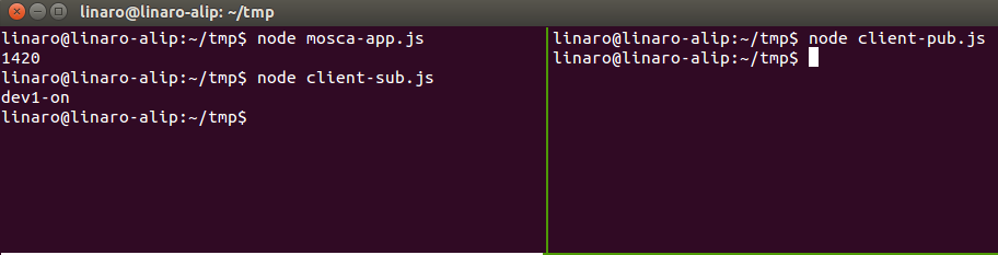

A pcDuino8 Uno makes a really great central hub for small IoT networks. It is very inexpensive, it consumes very little power and it has no fans or other mechanical parts that might cause failure. This post shows you the steps to get up and running with an MQTT broker.
Note: Ubuntu14.04 has been installed on pcDuino8 Uno.
1. Synchronize time
1
sudo ntpdate us.pool.ntp.org
2. Install Node and npm
Set up the apt-get repo sourc
